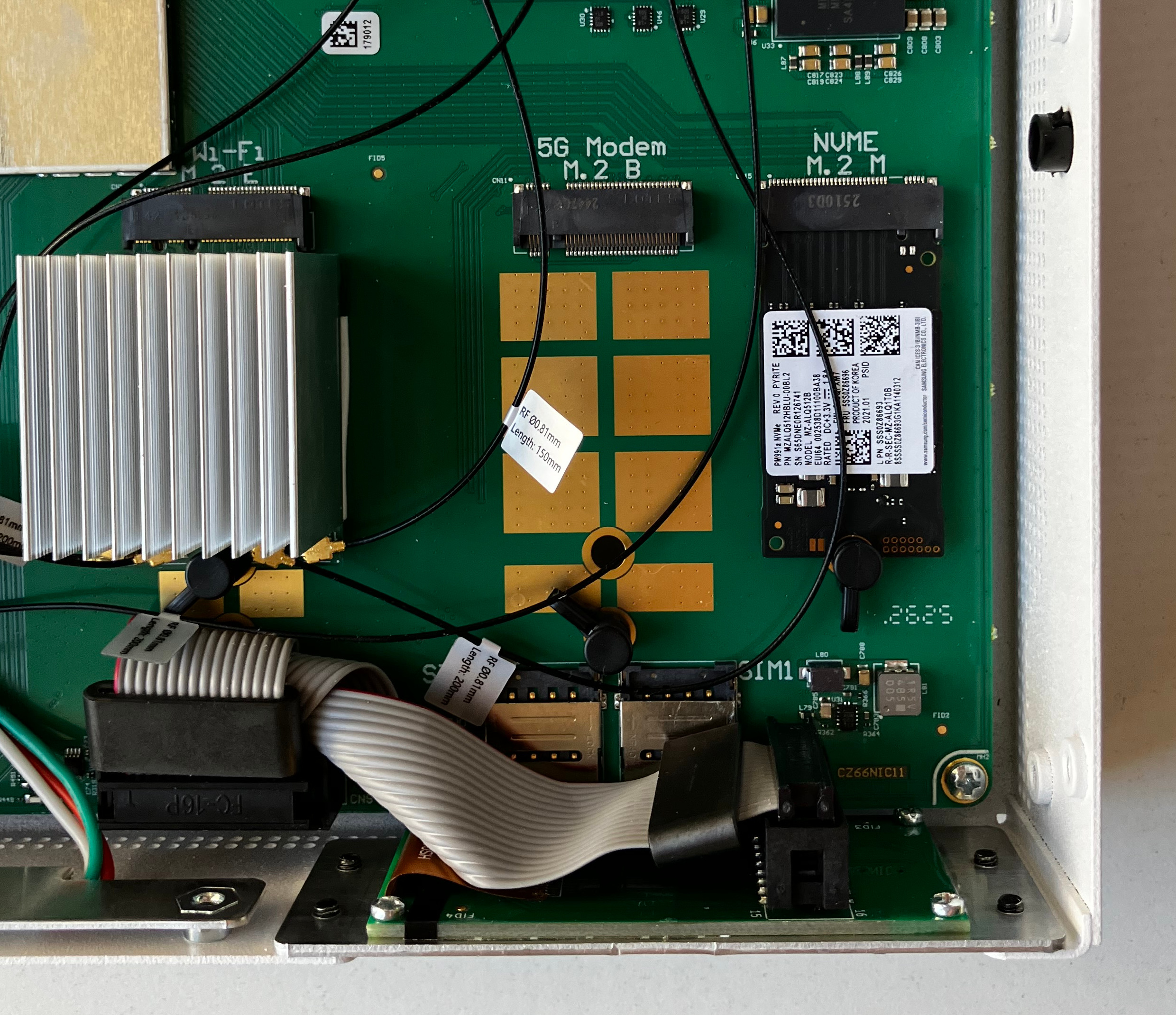

  1. Make sure your Turris Omnia NG is not connected to the power supply.
  2. Unscrew the six PH2 screws securing the top cover.
  3. Remove the D-pad button.
  4. Lift the top cover first at the rear part of the device and slide it out towards the front to avoid the D-pad stick at the front.
  5. The M.2 M key NVMe slot is located at the front right part of the device next to the display.
Notice
2230 SSD drives require you to remove the mainboard from the bottom case, in order to reposition the M.2 holder for the card.
Turris Omnia NG with an SSD installed
