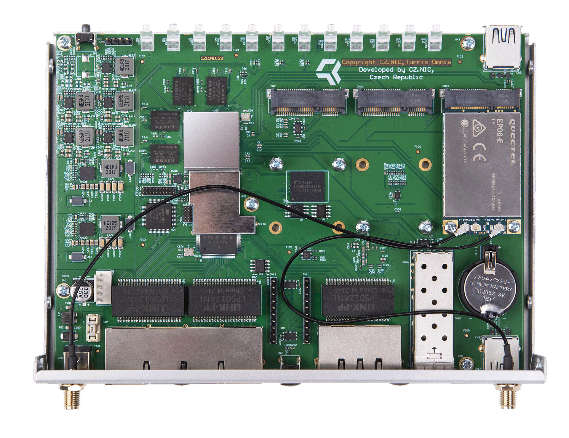

It is not yet possible to setup LTE in the reForis GUI, however you are able to use the below manual to set it up over ssh.
In order to use LTE, you need to equip your Omnia with an LTE modem. Turris Omnia LTE kit is based on the miniPCI card with modem chip Quectel EP06, so an LTE module category 6 optimized for M2M and IoT applications. It provides maximum of 300 Mb/s downlink and 50 Mb/s uplink speeds.
You will find the guide on how to setup the LTE connection over here.
