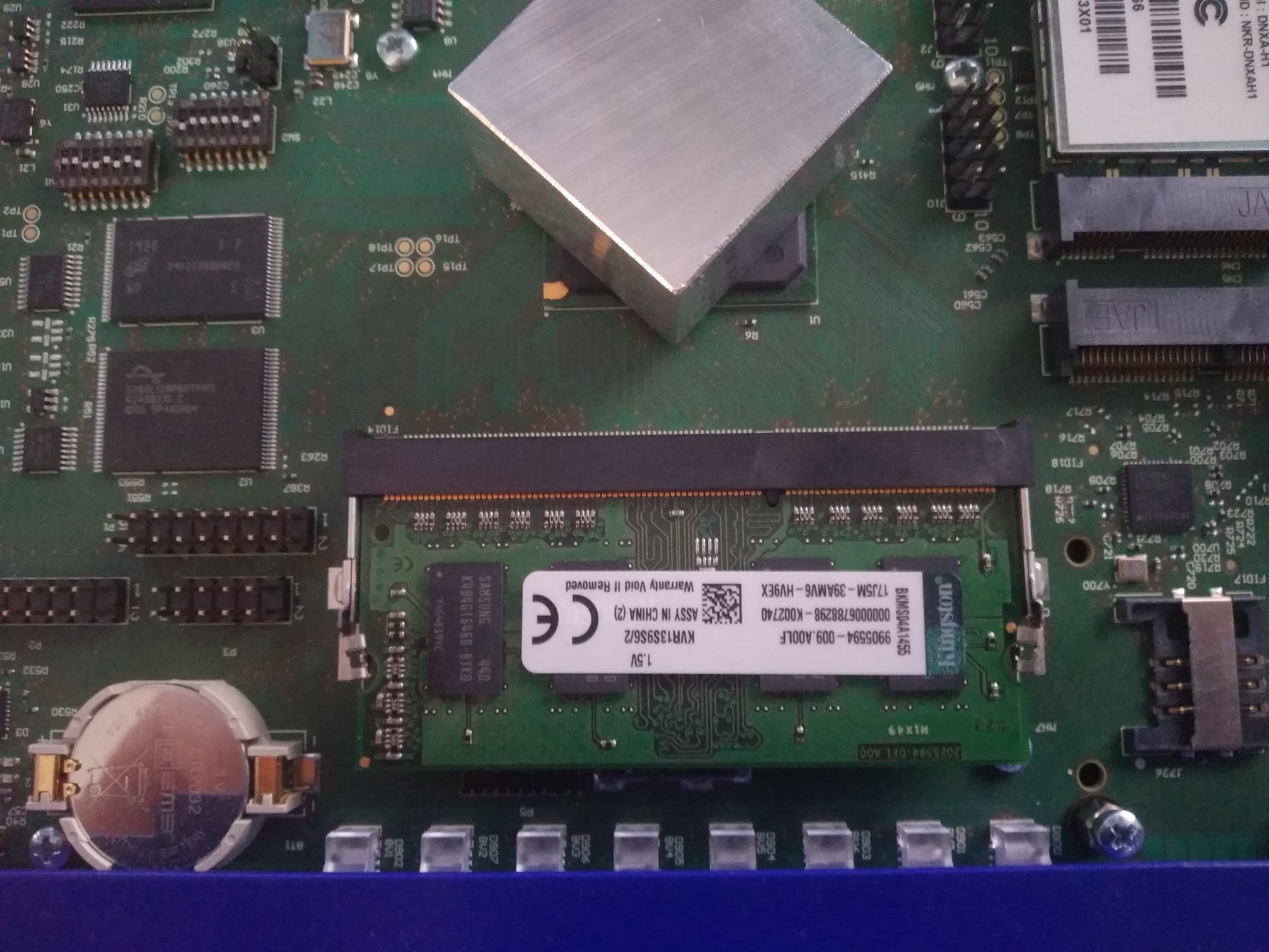

Carefully remove the RAM (located between the CPU and LEDs) by releasing the two latches.
RAM module with inserted RAM

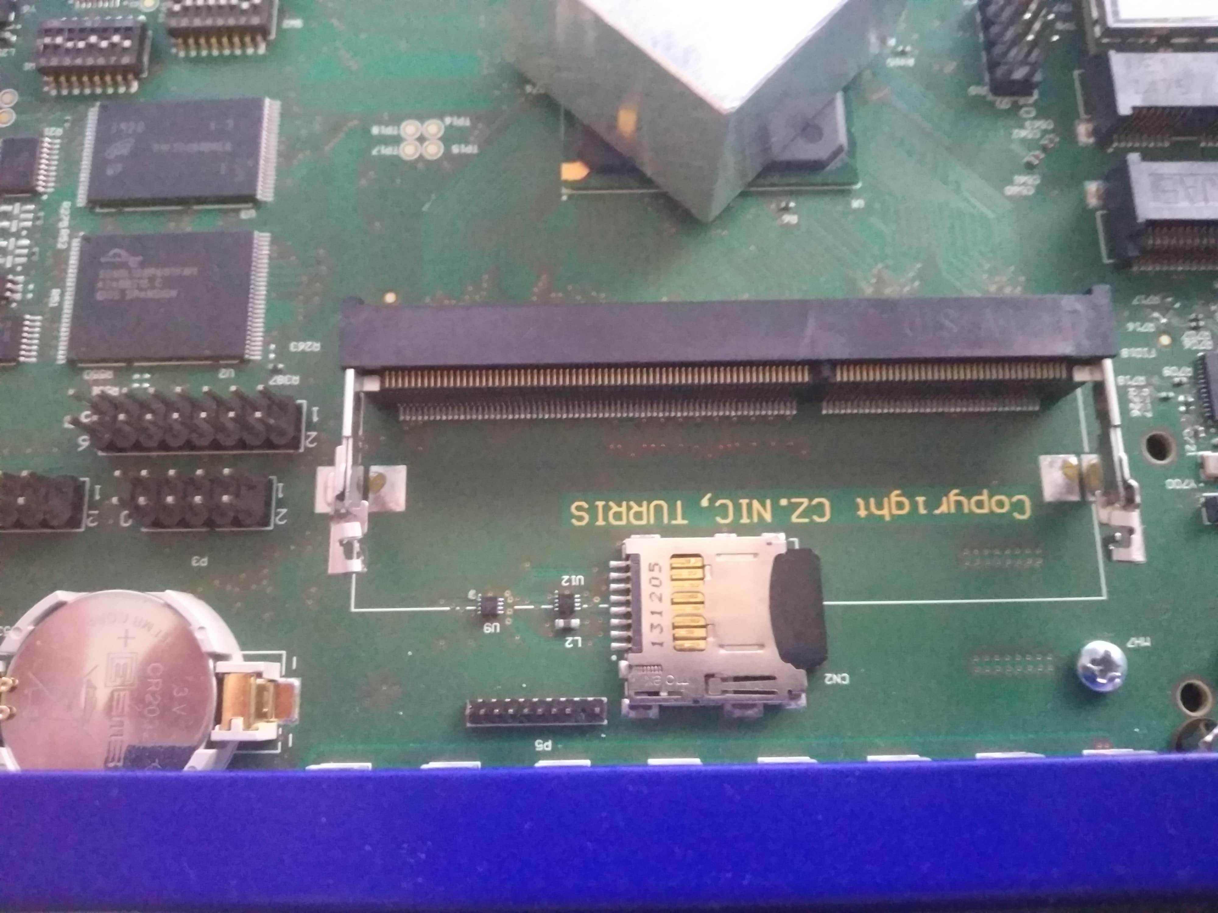

Insert the microSD card in the slot located under the RAM module.
RAM module without RAM and inserted SD card

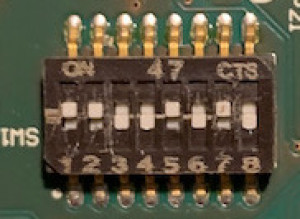

Locate the SW1 switch bar on the left side of the CPU if you have the router facing you with the LEDs.
Set the switches 1 and 3 to the pattern 011 010.
SW1 switch bar state 011 010

Set the switches on the SW1 switch bar to its original state 110 010.
SW1 switch bar state 110 010
